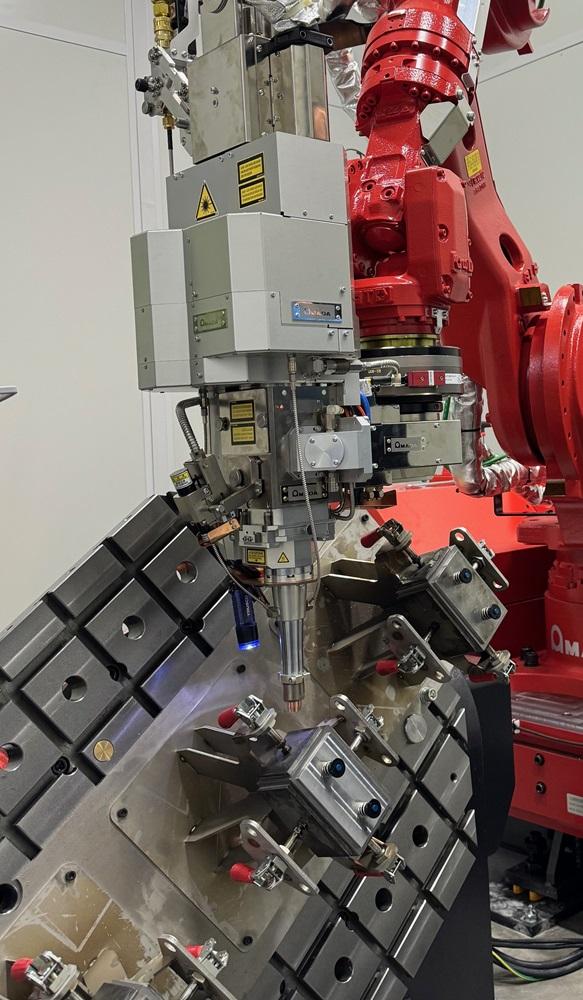

Earlier this year, Ryan Mongeau inspected an unassuming metal box—16-ga. formed and welded 1008 cold-rolled steel, 4 in. tall and deep, 3 in. wide. No big deal, right?
The weld didn’t look conventional, though. It certainly wasn’t MIG, but it wasn’t TIG either. It was, in fact, an autogenous, conduction-mode laser weld, which a robot performed to perfection over a half-lap joint (see Figures 1 and 2). Part of a fire alarm appliance to be mounted on the outside of a building, the box required no grinding or any other secondary operation. Even the corners were shiny and smooth. After welding, that box went straight to powder coating, then final assembly.
Installed earlier this year, the AMADA laser welding robot represented Mongeau’s latest project in an automation journey that’s only seven years old. During that time, the director of technology at Space Age Electronics has spearheaded a company-wide automation effort that’s been central to the manufacturer’s growth in recent years: automated blanking and part removal, automated bending, and now robotic laser welding.

A robot performs laser welding.
FIGURE 1. A fiber laser welding robot prepares to perform a conduction seam weld on a half-lap joint, from precision-cut and -formed flanges with automated blanking and bending. Fixturing keeps the flange positions to within ±0.005 in. Space Age Electronics

Challenges remained with fixturing, fit-up, and distortion. The robot wasn’t equipped with seam tracking, and issues arose with excessively large heat-affected zones that contributed to warping. Company engineers experimented with robotically welding some workpieces part way and then having TIG welders finish the job. Nothing seemed to work entirely as expected, an issue that eventually led to integrating an AMADA fiber laser welding robot in 2024.
Mongeau held up an unassuming box that’s now being welded with a fiber laser. To someone outside fabrication, a half-lap corner joint for an enclosure or box looks utterly ordinary. To someone who bends or welds for living, though, a box can be an impressive sight, especially if it’s formed to create a zero-gap joint with a minimal weld notch. A dialed-in program at the bending robot can make this happen. At the welding robot, a fixture with a series of toggle clamps and laser-cut components holds the piece to within a tolerance less than ±0.005 in.
“There is some variability in material, of course,” Mongeau said, “especially as we shift from one lot of steel to another. But it’s all accounted for in the fixture, which allows us to pull everything nice and tight.”

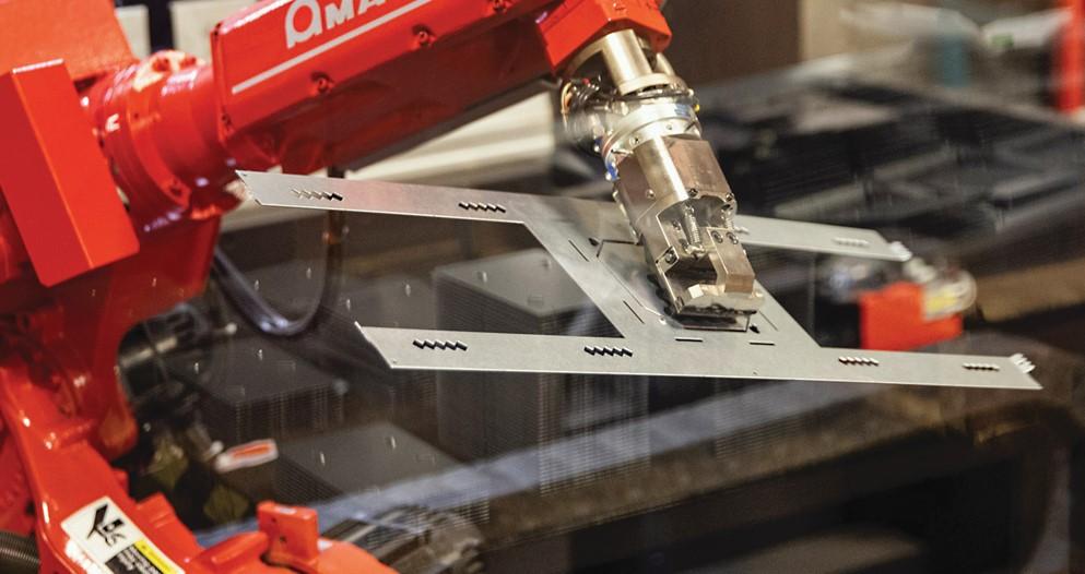

Fabricating the Claw
Mongeau described one high-volume product—the TCC Clawed Ceiling Bracket, which starts as an 18-ga. H-shaped blank, with narrow legs each 24 in. long. At the end of each leg are a set of teeth (the “claw” of the product) that, for anyone running a cutting machine with automated part removal, would raise some eyebrows. How could an automated part removal system lift the piece from the skeleton without interference?
In this case, the part design presented opportunity. The “claws” of the product had a flange bent to a 45-degree outside angle. The flange itself presented gauging challenges on the press brake; teeth geometries don’t provide the most rigid, repeatable surface for the brake’s backstops, especially when a bending robot is manipulating the part.
A bending robot holds a bracket.
FIGURE 3. A bending robot manipulates a “clawed” ceiling bracket. The narrow “toothed” flange at the right was formed on the punch/laser combo. This made automated part removal in blanking easier and simplified the bending sequence and gauging strategy at the robotic brake. AMADA AMERICA
Those flanges didn’t have to be formed on the brake, though. In fact, they could be formed on the punch/laser combo—a solution that killed two manufacturability issues with one stone (or punch hit). Once the punch form tool created the flange, the teeth were “lifted” out of the skeleton, eliminating all those potential snag points for the part removal automation. It also eliminated a tricky gauging sequence for the bending robot. And because the bend is open, at only 45 degrees, it stacks neatly on a pallet, ready for the bending robot to grasp (see Figures 3 and 4).

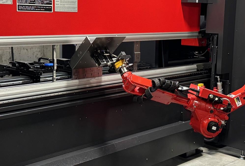

Streamlining the Bending Cycle
“It’s like an ongoing kaizen project,” Mongeau said. “When we automate a process, I work with the programmer and engineer, we go through simulation cycles, and within a few weeks or months we’re trying something different. We’re always asking, ‘How can we do this better?’”
Today, simulation can bring a part through every stage of a bending cycle on a robot. Programmers can simulate different grippers, bend sequences, and tooling strategies. Over time, Space Age programmers have learned to analyze that simulation and find ways to optimize the process. A tweak in a gripper design, for instance, can help better secure a part, while strategic rotations can help a robot move from bend to bend without ever letting go. A robot visiting a repositioning station once or multiple times prolongs the bending cycle. If a robot never lets go, it never loses its home position, allowing it to move steadily from bend to bend (see Figure 5).
Bend sequence matters for accuracy, of course, but as company programmers have learned, gravity plays a big role, too, especially when bending larger workpieces. Space Age gained this insight shortly after it invested in its latest AMADA robotic press brake cell with a 10-ft. bed. No bend program can defy physics. Depending on their geometry, some large, thin blanks will bow slightly as the robot manipulates them. To account for this, the robot carefully positions the first bend so that, before the brake ram descends, the blank sits precisely flat on the die shoulders. Humans do this naturally, but for large or long workpieces, at least, a robot’s program needs to account for this.
Whenever practical, the initial bend occurs along a large part’s longest flange. That long first bend makes the part rigid and reduces (usually eliminates) gravity’s effect for the rest of the bend sequence. “Once everything is flat on the tools, I make that first bend,” Mongeau said, “and then, after that, with the part rigid, we can really speed things up.”
Part Removal From the Combo
Automated part removal from the punch/laser combo has helped keep a steady drumbeat of blank production, but as company programmers have learned, the process also requires careful attention to detail. Sharp corners can cause issues—consider the serrated edge of the “claw.” Square corners can be important, too, for reliable gauging at the bending robot, something programmers factor in when creating those mini-nests that ease part removal (see Figure 6).
For most blanks with 90-degree corners (or less), programmers cut an additional gap into the skeleton, usually between 0.003 and 0.004 in., so the parts can be lifted without interference. Laser cutting kerf clearance also needs to be considered, especially since the width of a laser cut is a lot narrower than the gap left by a punch tool. Specific cutting toolpaths help give those edges more clearance, so they lift out without issue.
Perhaps even more important is the sequence that those cuts occur. Because the sheet moves, automated part removal must occur immediately after a part is cut out of the skeleton. How that skeleton takes shape depends on which parts are cut and removed first, and that sequence can have a big impact on the process.
Parts aren’t removed and transported over other parts in the nest, to avoid the possibility of collision. Beyond this, the lift-out sequence ensures everything stays flat even as the clamps move the sheet between cuts. A poor sequence can alter skeleton integrity, which can warp web sections and increase the chances of a part getting caught as it’s being removed.
To prevent this, Mongeau said he alternates the sequence where pieces are parted out and removed, sometimes near the clamps, sometimes away from them (near the front of the machine). “This helps us balance out the weight of that skeleton, so everything stays nice and flat. Again, this is especially important with the laser, which has that narrow kerf.”
A robot feeds a metal part to a press brake.
FIGURE 5. A robot forms a precision enclosure. To streamline the bending cycle, every flange, including the small return flanges, was formed without gripper repositioning. Space Age Electronics
